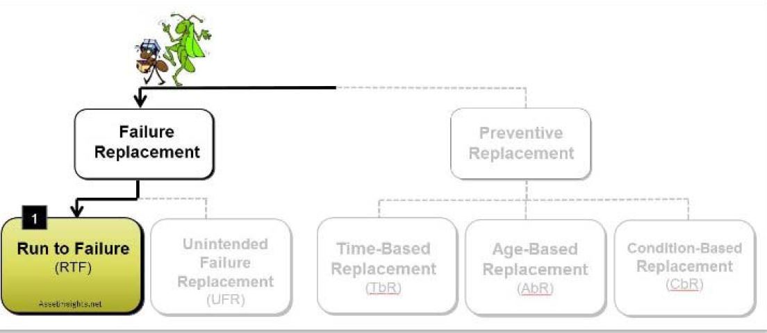

"There are further variations of these strategies," said the Ant. "I want to tell you about five different approaches to the end-of-life of assets... and here is a picture to illustrate".
The Ant handed the Grasshopper a network diagram of asset replacement strategies.
The Ant and Grasshopper sat comfortably in the warm and dry living room and pondered the diagram.
1. Run to Failure (RTF)
A conscious decision is made by the owner to neglect the asset until it fails. The owner understands and accepts the consequences of failure. There are many different types of consequences that may arise when assets fail, some being more severe than others.
An example. A professional assessment informs owners that their roof is very likely going to start leaking within the next five years. The owners understand the eventual consequence and decide not to spend any money on repairs or mitigation in the meantime. They wait for the leaks to start.
The Ant said. "You see, Grasshopper, the road leading to RTF is somewhat like you and I spending the summer singing and dancing while at the back of our minds we know that winter is coming. We have both agreed that when winter does arrive we will pull up our sleeves and together get down to some serious business."
