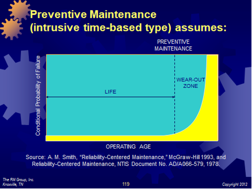

Recently, a member posed a question to other Society for Maintenance and Reliability Professionals (SMRP) members, prefacing the question with the fact that his management insisted on annual, mostly intrusive, maintenance, and based on the Original Equipment Manufacturer (OEM) recommendations, apparently with little or no exceptions. There are any number of problems with routinely and primarily applying a time-based intrusive approach to maintenance. Let’s start with the basics. Figure 1 below illustrates the assumption for classic time-based intrusive maintenance, that works on the assumption that your equipment has a certain operating life, beyond which it goes into a wear-out zone. Therefore, you conduct intrusive maintenance—replacement, overhaul, repair—as the time approaches.
Figure 1: Logic for time-based intrusive maintenance

However, this logic is rarely applicable according to those who study equipment failure patterns. According to those studies, 1–3.5% of failures fit this time-based approach (see Figure 2, second graph down, and Figure 3, regarding RCM results for age-related and random failure patterns). Incidentally, the distinction between age-related and random failure patterns seems somewhat arbitrary, at least to me: They all have a random element and are all on a time frame, which can vary dramatically depending on the equipment and its operating context. For example, the infant mortality period for a transformer with a 40-year life might be one year, but for a bearing, it might be a few days. In any event, this characterization is common across studies.
