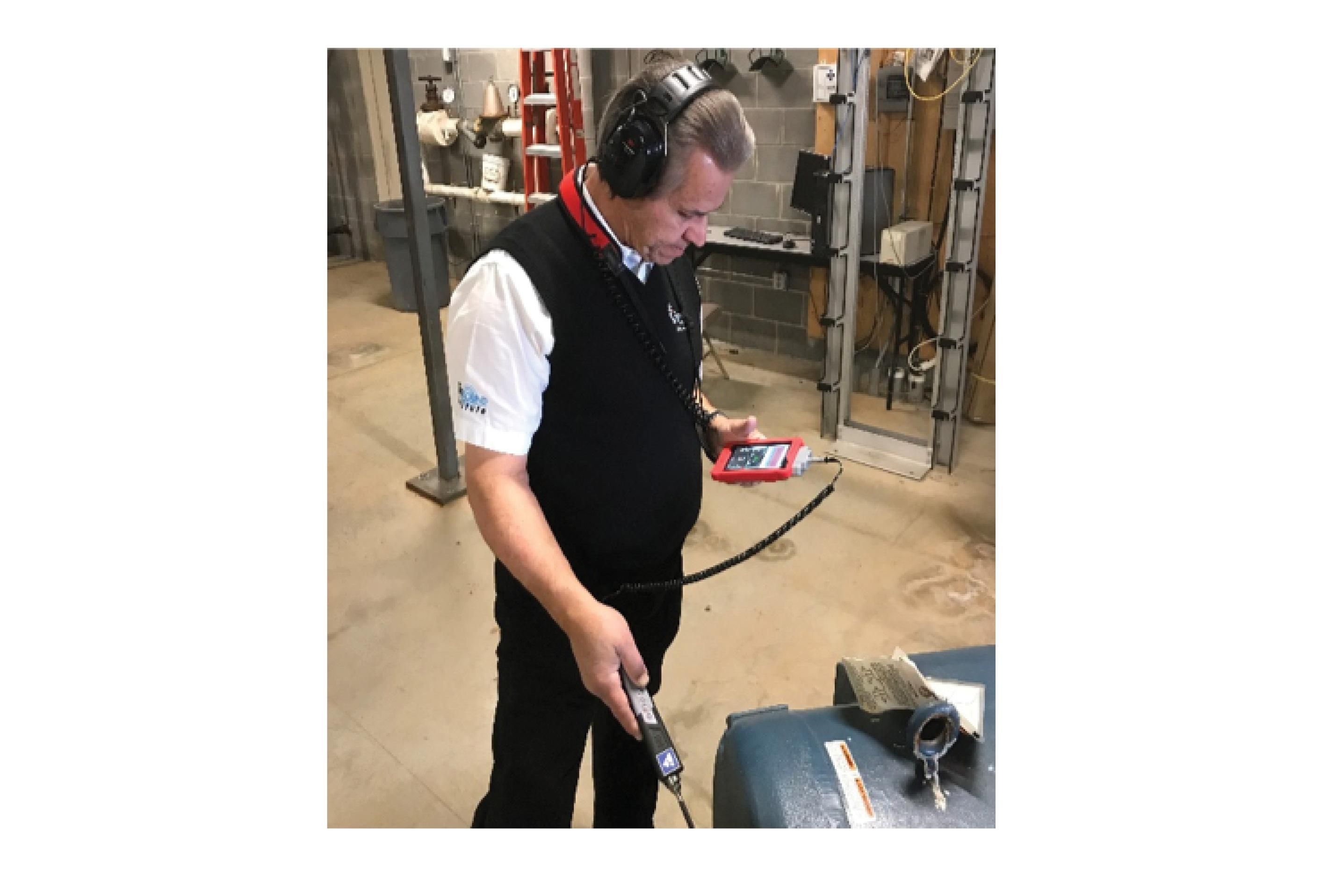

Figure 1: Using an ultrasound instrument to trend decibel readings for trending data (Photo courtesy of The Ultrasound Institute)

When trending bearings with ultrasound, once the reading is eight to 10 decibels above the previous baseline, then CBM, or you could say conditioned-based lubrication, is in order. In this case, acoustic lubrication would be the CBM.
To use an ultrasound instrument to view the decibel at the time of lubrication, you must be able to identify a beginning point. One option is the half-stroke method. As you lubricate using the half-stroke method, when the inflection point is noted, stop and give it 10 to 15 seconds to return to the decibel reading prior to the inflection point. (Note: In freezing or subzero weather, you may need to wait 20 to 30 seconds for the decibel to come back to the point prior to the increase.)
If the reading does not return to where it was prior to the inflection point, then stop lubricating. The half-stroke used confirms the bearing is not in need of any more lubrication. The procedure is complete. However, had the decibel dropped back to the starting point or less, another half-stroke would be warranted. Repeat this action until you reach the inflection point again.
