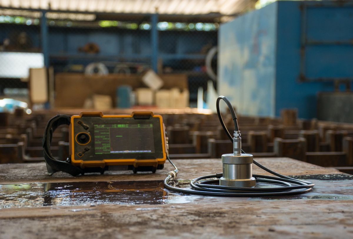

Acoustic lubrication is the use of a high frequency receiver or translator to detect sound that may relate to the condition of a motor bearing prior to lubricating the motor bearing.
Technicians should be trained to focus on the decibel because the rise in decibels means something is going wrong. Often times, technicians are told to focus on the sound of the bearing. However, what the practitioner hears through his/her own hearing may differ greatly from one person to another. The other problem with listening is that today’s digital ultrasound instruments are not as revealing as yesterday’s analog instruments. The highs and the lows are missing. For example, an analog instrument with frequency tuning allows the user to focus on certain sounds or conditions to detect brinelling4, balls out-of-round or ball defects, inner and outer race defects and under or over lubricated bearings. It is, however, a digital age, so data logging and waveform analysis are part of it, especially waveform analysis. A down converted ultrasonic (above 20,000 hertz) recording, which takes the high frequency signal and converts it to low frequency so it can be used for ultrasound signal analysis or converted to a decibel, can reveal numerous conditions or faults.
Today, there are instruments that adapt to your grease gun and allow the end user to simply use the ultrasound instrument and magnetic or contact transducer to monitor a motor bearing during the lubrication procedure. This is very effective in preventing over greasing of the motor bearings.
Acoustic lubrication is a viable means for CBM. Why? Simply put, ultrasound is the first means of detecting a fault before vibration or infrared. Also, the learning curve to use and implement an ultrasound program is short.
A good understanding of ultrasound and the many applications this technology offers is recommended prior to implementing an acoustic lubrication program, such as the equivalent to an ultrasound Level I training course.
Note: Prior to starting an acoustic lubrication program, you should follow your local plant’s recommendations and the original equipment manufacturer’s suggestions for removing the purge port, plugs, or bottom grease relief valves, when applicable. You should also know the type of bearing to be lubricated.
Granted, there are many different ways and different configurations used to apply acoustic lubrication. One way includes the use of an ultrasound instrument “fixed” upon a grease gun for a one person, two-handed operation. Second, is simply taking an ultrasound instrument in one hand and a grease gun in another, which may or may not require a second person.
Figure 4: Ultrasound is the first detectable signal on the P-F curve
Here is an example of the procedure:
Once you have the instrument and grease gun ready, place the zurk or hook onto the lubrication point. Many technicians prefer a button and hook with a short connection to the ultrasound transducer because the tightness of the connection provides a more consistent and repeatable decibel.
NOTE: Within the acoustic lubrication practice, technicians are instructed to implement greasing if the dB level is 10 or more decibels above baseline.
As you start the procedure, you may notice the baseline was 35 decibels for this motor bearing, but your reading today is 48 decibels (13 dBs above baseline). Using a grease gun with a handle, you choose to use the preferred half stroke method versus the full stroke method of the grease gun for this application. After a half stroke, you pause three to four seconds; no reduction or increase in dBs is evident. After a second half stroke, you pause another three to four seconds and again, no dB drop or increase is seen. Then, after the third half stroke, you notice the dB drop is two dBs. Another half stroke, pause and another two dB drop is seen. You are now getting a smidgen of grease on the bearing. Another half stroke, pause, a three to four dB drop is seen. Another half stroke, pause, the dB rises. This is the inflection point. Pause 10 seconds. If the dB level doesn’t return to the reading prior to inflection, you then log the reading and stop lubricating.
However, what if during the acoustic lubrication, inflection occurred (an increase of one to two dBs) after one half stroke of the grease gun? You should pause 10 seconds and if the dB reading does not return to where it was prior to inflection, you should stop the lubrication procedure. Do not continue greasing. Possibly, someone before you had lubricated the bearing. But, you say, “This bearing is still 13 to 14 dBs above baseline? What do I do?” Well, you make a call to a vibration technician to analyze the motor.
