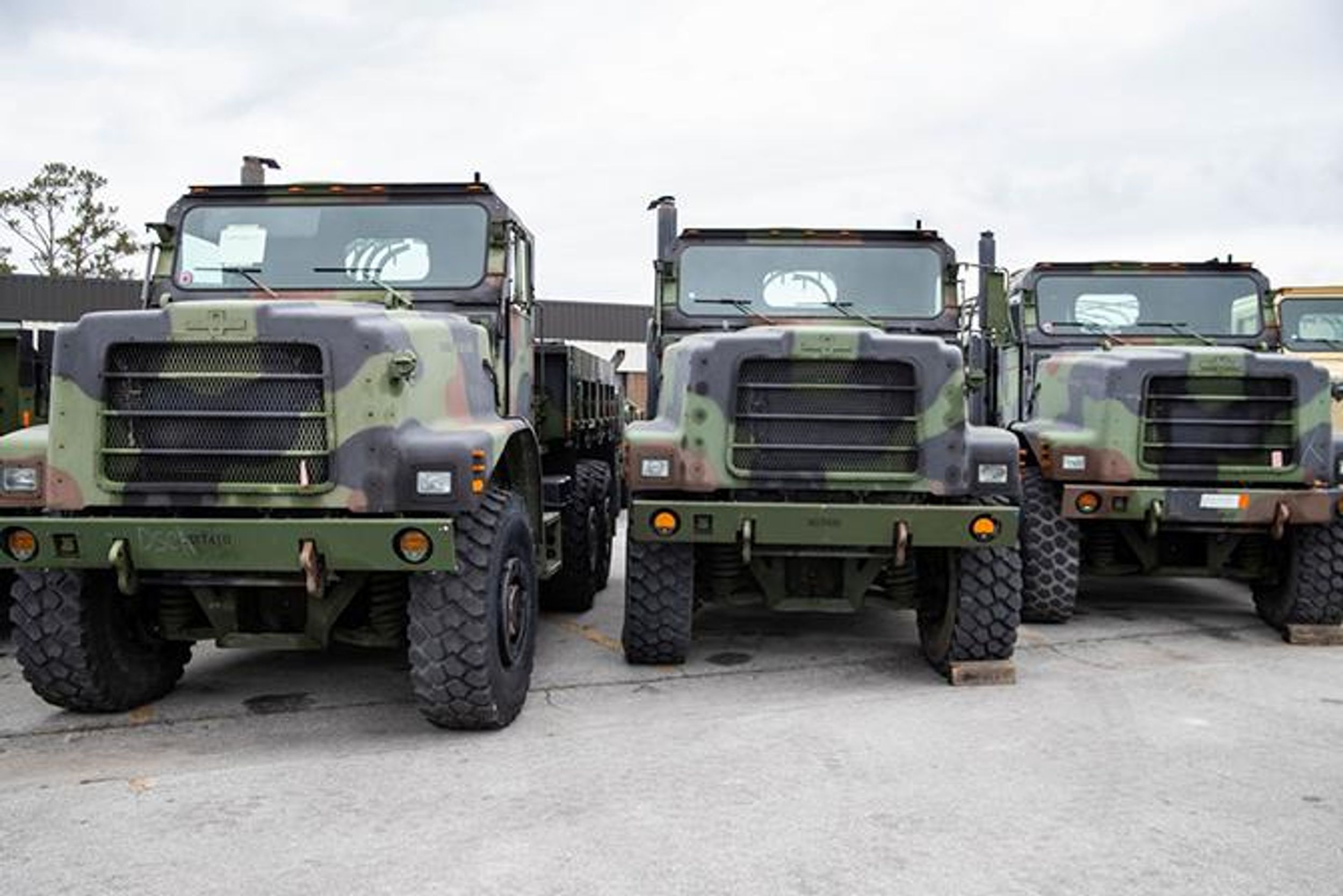

2nd Transportation Battalion (TB), a subordinate command of Combat Logistics Regiment 27, 2nd Marine Logistics Group, installed new logistics data-tracking loggers affiliated with the program known as Condition-Based Maintenance Plus (CBM+) on the unit’s Joint Light Tactical Vehicles (JLTV) and Medium Tactical Vehicle Replacements (MTVR) at Marine Corps Base Camp Lejeune, North Carolina, Feb. 1, 2022.

Kill Switch CBM+A kill switch connected to the Condition Based Maintenance Plus (CBM+) system sits on the dashboard of Medium Tactical Vehicle ReplacementsU.S. Marine Corps photo by Lance Cpl. Jessica J. Mazzamuto
