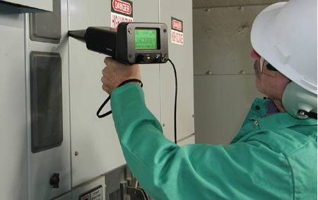

Ultrasound technology
Airborne/structure borne ultrasound instruments receive high frequency emissions produced by operating equipment, electrical emissions, and by leaks. These frequencies typically range from 20 kHz to 100 kHz and are beyond the range of human hearing. The instruments electronically translate ultrasound frequencies through a process called heterodyning, down into the audible range where they are heard through headphones and observed as intensity and/or dB levels on a display panel.
Adding ultrasound monitoring to standard lubrication best practices can prevent potential overlubrication of bearings, which can also lead to fewer bearing failures, extend motor and bearing life, and lead to a decrease in the amount of lubricant used.

A condition-based lubrication program requires a combination of trending bearing decibel levels and basic sound analysis. A baseline decibel level is set, along with (if possible) a baseline sound sample, and an inspection schedule is established for periodic testing. When a bearing sound level exceeds 8 dB with no change in the sound quality (usually a smooth, "rushing" sound), the bearing is considered in need of lubrication.
A lubrication technician, while listening to the bearing, will then apply lubricant, a little at a time, until the baseline level is reached. Stopping at that point prevents overlubrication.

During inspection using airborne/structure borne ultrasound, the inspector will sense friction in mechanical instruments. Trending associated amplitude levels and changes in sound quality of a bearing also provide early indication of conditions such as lack of lubrication and overlubrication.
Beyond its ability to detect premature or existing bearing failure or over/underlubrication conditions during a route, the newer digital ultrasonic instruments (such as the Ultraprobe® 10000 and 15000) utilize data management and sound analysis software to predict potential failure conditions.
These digital instruments will enable the plant technician to set baselines, log data, record sound samples for spectral analysis, and analyze sounds. Some of the newer portable digital instruments have onboard spectral analysis and data software to allow for on-the-spot analysis.
