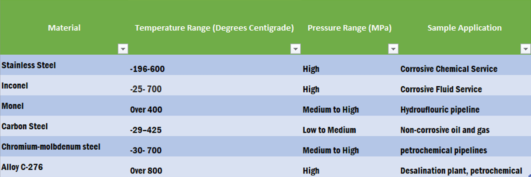

Stainless Steel
Most chemical service valves are fabricated using stainless steel, which is resistant to chemical corrosion by certain fluid combinations. Stainless steel is available in several forms. Stainless steel type 304L provides optimum chemical resistance for pipelines conveying nitric acids and other highly corrosive fluids.
Stainless steel type 316 contains molybdenum, which enhances corrosion resistance and offers the valve body better performance for severe fluid service. Valve bodies made of these materials can accommodate a wide temperature range (-425oF to 1500oF) and can withstand fluid flow conditions that cause pitting and creep.
Inconel
This is an advanced valve material that is a blend of chromium and nickel alloys. This material composition increases the valve’s corrosion resistance and enables the valve body to withstand extreme process temperatures and pressure. Additionally, this material is resistant to oxidation and can be utilized for reactive chemical fluid service.
Monel
Monel is a nickel alloy that contains substantial traces of iron, copper, manganese, and silicon. Valves with bodies made of Monel are common in saline fluid applications. Monel has excellent corrosion resistance, making it suitable for fluid applications with high fluoride and hydrogen content.
Carbon Steel
Carbon steel is among the most popular materials for constructing valve bodies, since they are easy to manufacture. Carbon steel valves are suitable for low- to medium-pressure fluid processes.
Manufacturers use wrought carbon steel or forged carbon steel. Wrought carbon steel (WC) is available in three grades (A, B, C), and is classified as WCA, WCB and WCC with WCC being the strongest. Valve bodies made using WCB are suitable for low-temperature applications, where the service media is non-corrosive. WCC can accommodate fluid applications operating at temperatures below 800oF. Such valve bodies can facilitate the flow of non-corrosive fluids and gases. Valves with carbon steel bodies are common in pipelines transporting compressed air as well as saturated and superheated steam. Exceeding the 800oF temperature limit transforms carbon into graphite, impacting valve performance.
Chromium-Molybdenum Steel
Some fluid applications, such as steam service, experience high rates of erosion corrosion due to the extreme temperature and pressure. Manufacturing valve bodies for such processes requires materials that have superior corrosion resistance. Chromium-molybdenum steel is popular in pipelines transporting fluids with high sulfur content.
There are several grades of chromium-molybdenum steel, including WC9 and C5. C5 is prone to cracking when welded. Generally, chromium-molybdenum steel valve bodies are more difficult to cast but provide dependable and durable fluid service.
Alloy C-276, a nickel-chromium-molybdenum alloy, has superb corrosion resistance and is suitable for chemical pipelines. Other materials used for valve bodies include:
