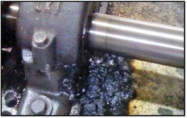

36% of bearing failures can be attributed to over-lubrication. Excessive grease in a bearing causes overheating; liquefaction of the grease and subsequent damage to the bearing.
34% of premature bearing failure is due to fatigue caused by excessive loading, typically caused by shaft misalignment and rotor imbalance. Other causes include improper handling/installation (16%) and lubricant contamination (14%).
