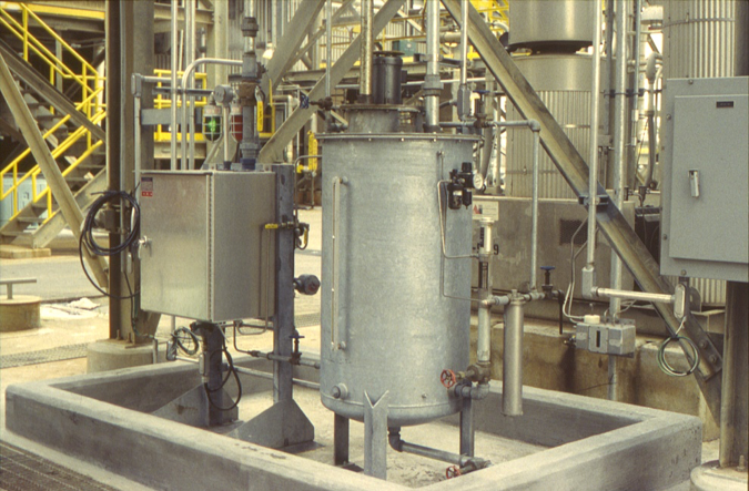

Figure 1 depicts a closed oil mist system with separate supply and oil mist return headers. This article, though, illustrates a slightly different system, namely one where the supply header doubles as an oil return header. However, in either system, a small (painted blue in figure) oil collecting tank is located near the outboard end of each drive motor, as shown in Figure 1. After wetting out and thus lightly coating or lubricating the various motor and pump bearings, the spent oil is carried off in its instrument-quality “carrier air” in the form of small atomized oil globules. These atomized oil globules and much larger drops of coalesced liquid oil are piped into the nearest small blue tank. Whenever a quart or liter of oil has accumulated, a plant operator strokes the small, built-in piston pump (visualize a bicycle tire pump). In single header systems, the oil is pushed upward in a vertical pipe and into the slightly sloped supply header. After slowly flowing back and then leaving this sloped header, the oil re-enters a vertical pipe and is led to a small oil reservoir inside an oil mist cabinet of the type and configuration shown in either Figure 1 or the midsize oil mist cabinet shown in Figure 2.
Figure 1: The oil mist console in the foreground contains a small oil reservoir and an oil mist generator nozzle (an ejector-like stationary part) where instrument air and lube oil meet; the dark oil mist return header ends at the coalescing and collecting vessel, far left
Figure 2: A medium-sized oil mist console is shown on the left; an oil return tank with its associated blower is positioned on the right

When tracing the pipes in Figure 1, note that this version of a widely used closed oil mist system has an oil return header separate from the oil supply header. Oil and oil mist from the blue box are fed into one of two sloped headers. This would be the return header, with a pressure near or slightly below atmospheric. The header pressure, either slightly positive or negative, is produced by the small blower located at the top of the freestanding, stainless steel tank at the extreme left of Figure 1.
However, this blower, which is also shown on top of a similar stainless steel tank in Figure 2, serves two important purposes: (a) It develops a suction pressure below that in the oil mist supply header and, (b) Crinkled wire mesh, securely fastened near the periphery of the impeller discharge vanes, causes any remaining atomized oil droplets to coalesce. It then travels through a filter into the collecting tank and, from there, a fractional horsepower electric pump sends the clean oil into the oil mist cabinet’s small reservoir for reuse.
