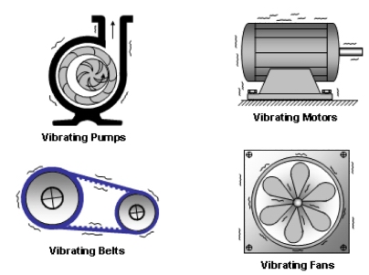

Shown below are some examples of undesirable machine vibration.
undesirable machine vibration.undesirable machine vibration.
