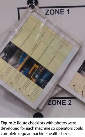

As relationships and teamwork strengthened, another positive result occurred. Operators began volunteering to take on more basic machine maintenance. Using standard work, maintenance technicians trained operators on these tasks. This freed up the technicians to take on other jobs and work down their order backlog.
