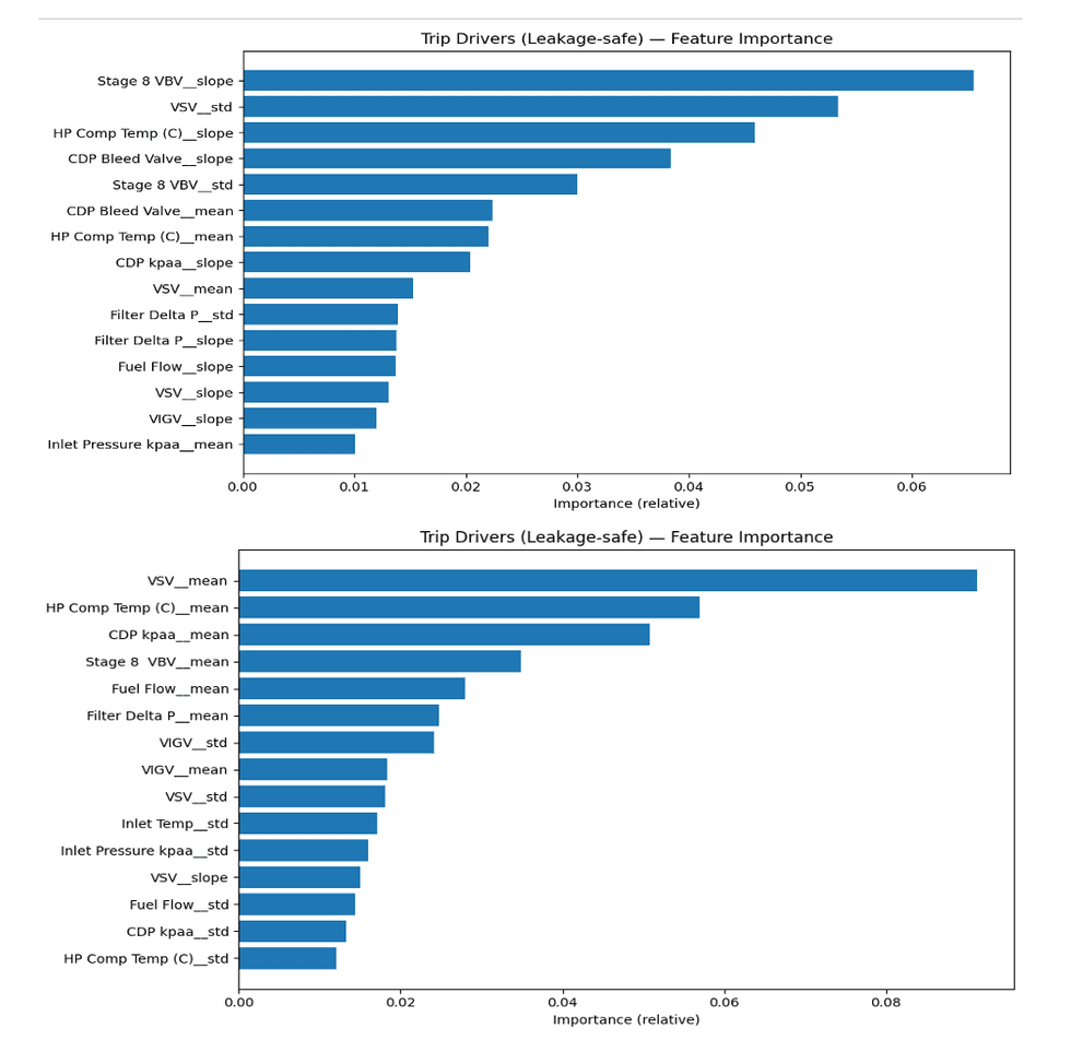

When properly structured, however, machine learning models can provide significant value. By identifying and ranking the variables most associated with undesirable outcomes—such as trips or power fluctuations—they help direct engineering attention toward the factors that matter most. In this study, the variables highlighted by the models aligned with independent findings from the OEM, which identified concerns related to variable bleed valve (VBV) behavior. This type of alignment between data-driven insight and domain expertise is critical. It builds confidence in the analytical approach and ensures that results can be translated into practical actions, such as targeted inspections, control system evaluations, or component-level assessments. Beyond identifying key drivers, additional analysis—such as sensitivity or elasticity assessments—can further quantify how changes in one variable influence another. This provides a deeper understanding of system responsiveness and supports more informed decision-making when evaluating operating adjustments or maintenance strategies. From a business perspective, the implications are significant. Performance degradation or operational constraints in complex equipment can translate directly into financial loss. For example, a sustained reduction in power output—even by a single megawatt—can result in substantial revenue impact over time, depending on market conditions. More importantly, delayed diagnosis of underlying issues can amplify these losses and increase operational risk. This is where reliability leadership plays a defining role. Effective leaders must be able to bridge technical understanding with timely decision-making—ensuring that emerging issues are identified, prioritized, and addressed before they escalate. Machine learning and data-driven methods provide a powerful complement to this process by reducing uncertainty and accelerating convergence toward root cause. However, these tools must be applied with discipline. Incorrect assumptions, poorly selected features, or inadequate model validation can lead to misleading conclusions and wasted effort. Analytics should not be viewed as a substitute for engineering judgment, but as an extension of it—enhancing the ability to interpret complex systems rather than replacing foundational knowledge.

To further focus engineering attention, machine learning models were used to rank variables based on their contribution to specific outcomes. The key drivers associated with trip events and power fluctuations are summarized in Figures 5 and 6, respectively. These results highlight a relatively small subset of variables that consistently influence system behavior.
reliabilityweb.com
Figure 5: Feature importance showing higher contributing features leading to Tripping between the two turbines

Notably, the variables identified through the analysis aligned with independent OEM findings, which highlighted concerns related to variable bleed valve (VBV) behavior. Supporting trends from the control system are illustrated in Figure 7.
