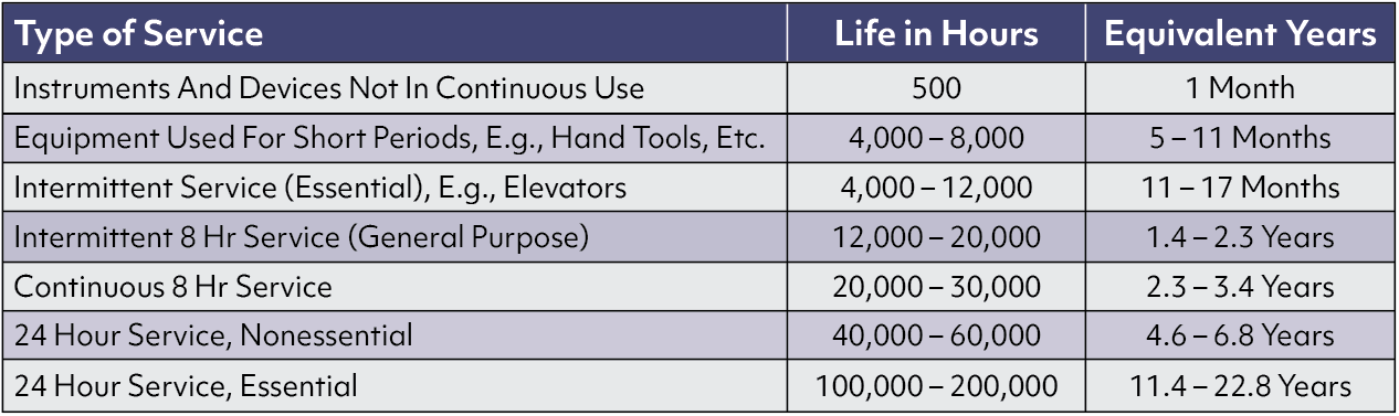

Figure 1 illustrates some general rules of thumb that engineers are taught to apply.
Figure 1: Rules of thumb for engineers
