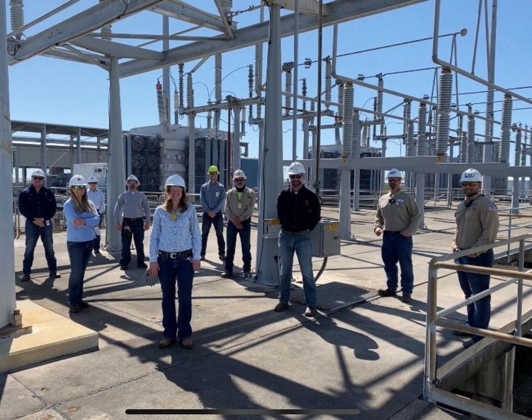

LOOP and Strategic Partners practice social distancing during a Pre-Job Safety Kick-Off Meeting prior to performing a 115kV Substation PM at the Fourchon Booster Station near Port Fourchon, LA
