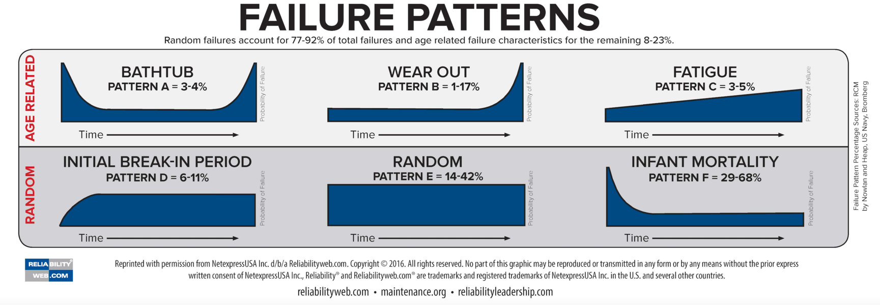

Failures during an asset's life can be attributed to the following causes:
Design Failures: This class of failures take place due to inherent design flaws in the asset or system. In a well-designed system, this class of failures should make a very small contribution to the total number of failures. Research by Winston Ledet (outlined in Don't Just Fix It, Improve It! A Journey to the Precision Domain) showed that approximately 20% of corrective work orders could be traced to poor design, build and installation issues.
Infant Mortality: This class of failures cause new (and repaired) assets to fail. In "Reliability-Centered Maintenance" by Nowlan and Heap, up to 72% of failures are in the "worse new" or "worse repaired" (infant mortality) category.
Random Failures: Random failures can occur during the entire life of an asset. These failures are also referenced in "Reliability-Centered Maintenance" by Nowlan and Heap. Up to 77-92% of failures are random in pattern.
Wear Out: Once an asset has reached the end of its useful life, degradation of component characteristics will cause assets to fail. Ledet research stated that "wear out" as a cause for a corrective work order is 12% or less. Nowlan and Heap and related research shows 8-23% of failures are wear out related.
The following graphs shows the contribution of the different failure modes towards the overall failure rate.
