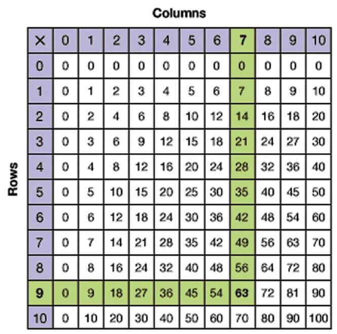

Using RIME is very similar to using a multiplication table. You simply pick a column and a row, and where they meet is the answer. The rows correspond to the work request priority and the columns indicate the asset priority. Therefore, if you pick a work request priority and an asset priority, you can easily select the correct work order priority.
To make this more tangible, let's work through an example. Assume we are having a problem with a pump that is part of a manufacturing process. Because this pump is a process-oriented pump, we will need to use the column labeled "Process Equipment" within RIME (see Figure 2).
Assume the pump is still running, but is no longer providing the throughput required to optimally run the production line. As a result, we are still making product, but not at the desired rate to meet customer demand.
In this situation, we would use the row labeled "Reduced Production," as shown in Figure 3.
When you connect the row and column, you will see that they meet at work order priority #1 - complete within two days (see Figure 4).
