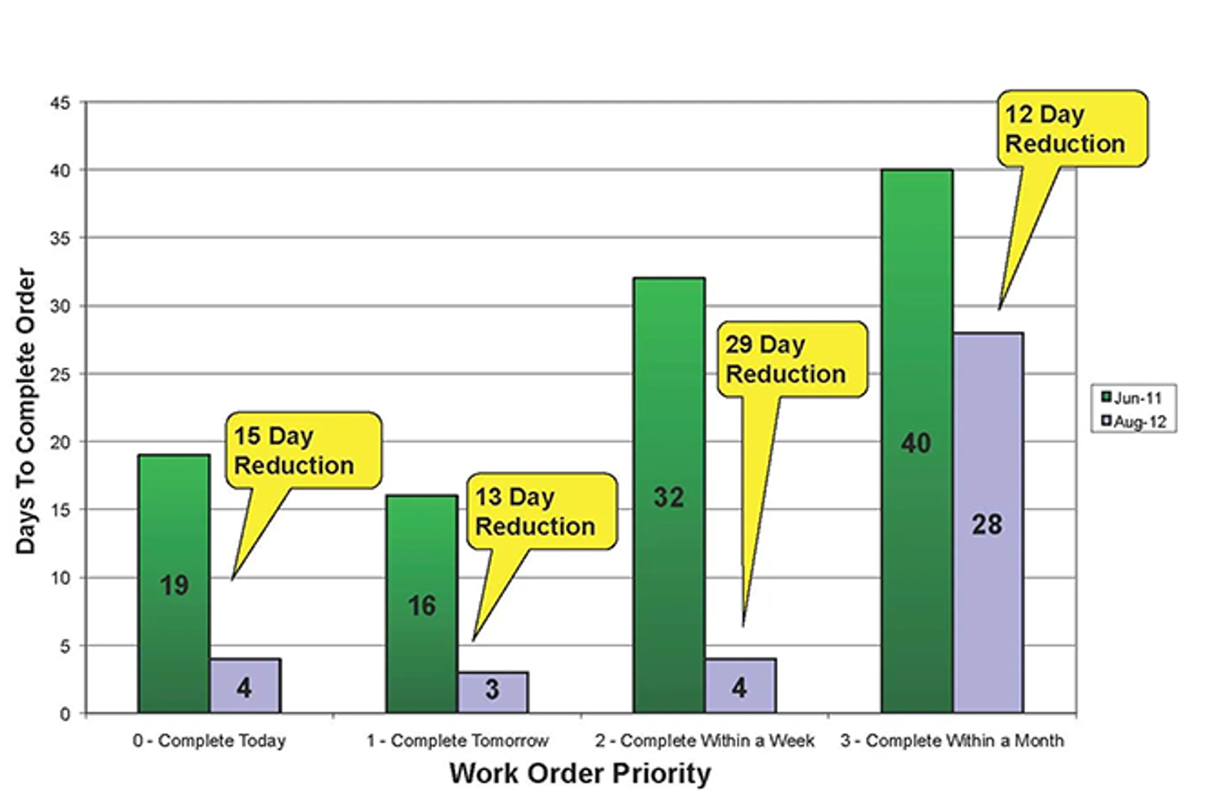

Before we started focusing on adherence to RIME, work orders were seldom completed by their designated due dates (see Figure 5).
Part 1
Figure 5: Median Time to Complete Orders: June 2011
When we dug deeper into the situation, we realized we were not following RIME 100 percent of the time. It was at this point that we decided to focus our efforts on proper work order prioritization. Each week, we would review work orders that were created and measure adherence to RIME. We did our best to provide praise to those who followed it and guidance to those who did not.

To answer these questions, we had to go back and determine if we got any better at completing work orders by their designated due dates.
As can be seen in Figure 7, RIME adherence actually got us a great deal. By prioritizing work properly, we were able to achieve a two to three week improvement in response time for each work order priority.
Part 1
Figure 7: Median Time to Complete Orders: August 2012
Another nice benefit of focusing on work order prioritization is that our schedule compliance rose from 63 percent to 77 percent. As people began to put more thought into their work order coding, they were less likely to "break-in" to their existing schedule to get work done.

This issue definitely illustrates a paradigm in the maintenance industry. When you "feel" like you are providing the best customer service, you are actually doing quite the opposite. This became evident by our original data (Figure 5), where we acted on emotion and were unable to meet our deadlines.
When we replaced emotion with logic and RIME (Figure 7), we were able to truly meet customer demands and do so two to three weeks faster.
