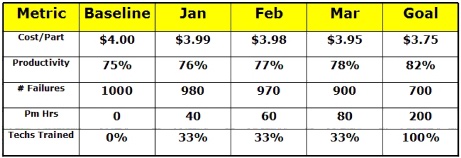

The Balanced Scorecard is a set of measurements you put together to measure your plans performance. They are the measurements developed when you answer the previous questions. The measurements have four perspective and they are Financial, Production or Customer, Maintenance Processes, and Innovation & Learning or People. These four perspectives make up your overall strategy plan. It is the result of answering the previous questions.
The process of answering these questions is done with the use of a Strategy Map. A Strategy Map is a pictorial representation of the four perspectives and how they interrelate to one another. You can draw out your plan on a Strategy Map and talk through it in fairly quick fashion. This is a great practice use to get buy-in to the plan before you spend too much time on it. If management believes in your concept you can do the financial work to justify any investment required. If they don't buy into the plan then make another plan. The Strategic Plan is based on several cause and effect relationships. This is known as the hypothesis of your plan. Basically the plan explains that is the plant needs improved financial performance then some production measurement must improve. Of the production measurement is to improve maintenance must perform some process or processes to make the assets perform better improving production performance. And if maintenance is to improve its processes certain learning or innovation must take place. This flow of cause and effect relationships is what explains your plan. Also the cause and effect has timing dynamic to it. The Learning and Innovation measurements will improve first. Next the maintenance process measurements will improve. Then the production measurements will improve. And lastly the financial performance of the plant will improve. Its important that everyone understands the timing in order to set proper management expectations. This timing dynamic is known as leading and lagging indicators. Leading indicators are the Learning and Innovation along with the Maintenance Process measurements. When the leading indicators react as planned we can feel confident we are executing a good plan. When they don't behave as we wish we may need to revisit the plan and our hypothesis for the plan.
