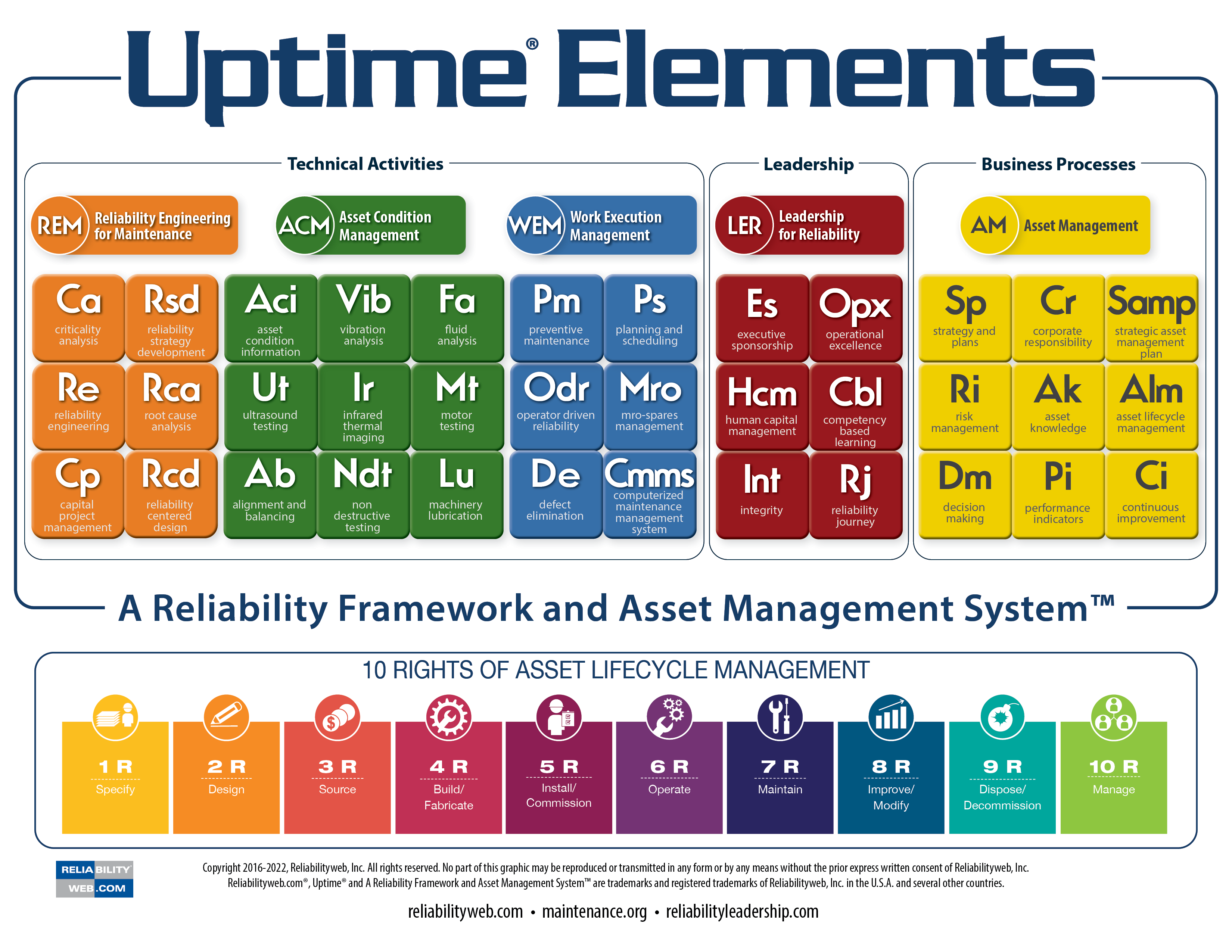

The Uptime Elements™ framework includes five domains:
  • Reliability Engineering for Maintenance (REM);
  • Asset Condition Management (ACM);
  • Work Execution Management (WEM);
  • Leadership for Reliability (LER);
  • Asset Management (AM).
Figure 2: Uptime Elements Framework
Within the ACM domain, there is an element known as asset condition information (Aci). It comprises all the data, observations and conditions of an asset. This information is more than just current state; it is the cumulative condition of an asset over its lifecycle.
This approach enables day-to-day decision support and is a prognostic of future conditions. Therefore, data collected through CBM is a key component in Aci. This allows for the detection of early onset failure and is normally aligned to known failure modes. This would include vibration analysis, oil analysis, ultrasonic testing, nondestructive testing and any other methodology of analyzing the condition of an asset with regards to its deviation from its normal operating condition. The use of CBM to ascertain the onset of failures is only as valuable as the information collected.1
