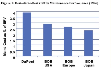

The basis for our approach originated in DuPont in the late 1980s. Faced with a decentralization of their maintenance department, DuPont was interested in how to sustain their functional excellence in maintenance. DuPont, normally an inwardly focused company, did something fairly unusual at the time. They engaged A.T. Kearney to benchmark their performance against the "best-of-the-best" in the U.S., Europe and Asia (Figure 1). DuPont found that they didn't need to worry about losing functional excellence because they did not have it to begin with. The most dramatic difference in performance was with the Japanese who had much lower costs with greater reliability and lower stores inventory.
Up to this point, the focus of the benchmarks had largely been on the maintenance function and maintenance cost. Statistical analysis of the benchmarking data seemed to indicate that just a few variables in the benchmarks accounted for almost all of the variation in performance, but all of these variables were fundamentally cost variables. The implication of this analysis was: focus on cost reductions to achieve "best-of-the-best" performance. However, the benchmarking team who had participated in the site visits during the benchmarking knew that the best performers did not focus on cost much at all. They had a suspicion that these improved cost factors were the result of good maintenance and not the cause, so they began to dig more deeply into the structure of reliability.
