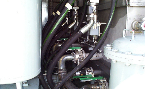

Examples of Unreliability & Maintainability:
How somebody is going to perform maintenance on this
equipment?
How long it will take to replace a leaky hose
on this equipment?
It will be a challenge to replace pump or motor
on this unit.
Maintenance had to cut a hole to make an
opening to reach hidden (broken) component.
