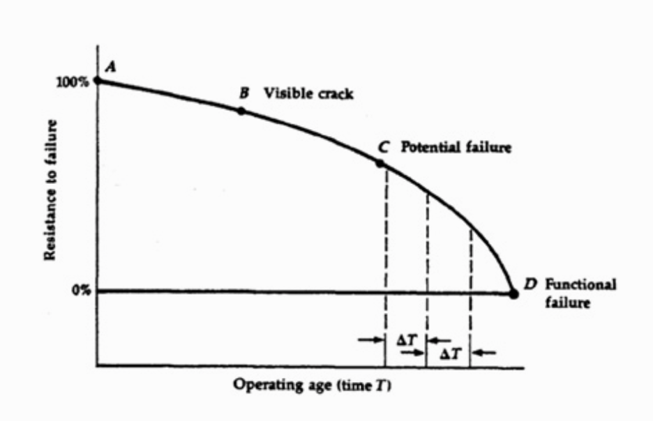

The P to F Curve by Nowlan and Heap
The D-I-P-F Curve [Design-Installation-Potential Failure - Failure] Curve
When Stan Nowlan and Howard Heap (with significant help from Tom Matteson) published Reliability-centered Maintenance in 1978 one of the breakthroughs was the P-F Curve which we have since expanded to the D-I-P-F Curve pictured above.
The idea is to inspect an item to detect a potential failure - a potential failure is an identifiable physical condition which indicates that a functional failure is imminent” so that one can schedule a corrective intervention prior to a function failure event.
Like a doctor testing for a virus (testing NOT predicting) so they can issue a diagnosis, highly-skilled technicians use advanced sensing instruments to detect an identifiable physical condition which indicates that a functional failure is imminent. They provide diagnosis not prediction. An airplane full of people would not take off based on a prediction of maintenance requirements.
