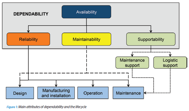

Dependability is the term that has been adopted internationally to cover the main attributes of availability, reliability, maintainability and supportability (see Figure 1). Quite often, the term reliability is used as a blanket term to include all these attributes. This proliferation of terms leads to considerable misunderstanding of this important engineering discipline, thus adding to the need for standardization.
The main dependability attributes of an item are:
  • Reliability for continuity of operation;
  • Maintainability for ease of preventive and corrective maintenance actions;
  • Supportability for provision of maintenance support and logistics needed to perform maintenance;
  • Availability for readiness to operate.
Reliability is an inherent result of the design and is sustained by proper operation within prescribed conditions of use and appropriate maintenance. Maintainability is dependent on the system design architecture and technology implementation and is guided by maintenance strategies. It is primarily a function of an item's design and installation. Supportability is the ability of an item to be supported from a maintenance perspective and consists of two components, maintenance support and the logistics required to deliver that maintenance support. The starting point for supportability is the maintainability of the item, which is then enabled with specific resources and logistics necessary for the use of the item. Availability is the result of a combination of reliability, maintainability and supportability appropriate for the application.
Thus, dependability is a general term that provides a framework for these attributes, as well as others, such as recoverability, durability, operability and serviceability. Safety is not considered a direct attribute of dependability, although the two are closely related. Safety is enhanced when dependability is integrated into the design and operation of an item.
