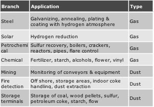

With the addition of ATEX and ICEEx certification, the MI3 series can now be used in many additional areas - for example, in steel industry processes using hydrogen atmosphere, such as galvanizing, annealing, plating and coating. Other application areas include hydrogen reduction in the solar industry, petrochemical (sulfur recovery, boilers, reactors, pipes, flare control) and chemical (fertilizer, starch, alcohols, flower, vinyl) processes, mining (monitoring) conveyors and equipment, fire detection and storage terminals (coal, wood pellets, sulfur, petroleum coke, starch), hazardous waste disposal and sewage, as well as ink, laminate and coating processes that emit volatile vapors, and many more.
