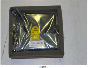

For many electrical parts, particularly parts with circuit boards, the three main environmental hazards that need to be guarded against are temperature, humidity and Electro Static Discharge (ESD).
During the last twenty years, the nature of electronics used in running a manufacturing plant has changed through the use of more advanced computer controlled equipment. This equipment relies on the use of printed circuit boards that require a low humidity environment with little fluctuation in temperature. Changes in temperature and humidity can cause the micro connections between the components and the printed circuit board to separate or warp. These components are also subject to short circuits from small amounts of voltage, the source of which can be as small as a micro-discharge from the person holding the part. For this reason, these electronic parts must be kept in their special ESD packages, usually a black bag made of non-conductive material originally supplied by the manufacturer. These parts can be so sensitive that even when ESD parts are removed from their special package, the handling person should be grounded using a specially designed ground strap to avoid ESD damage.
Figure 1 is a picture of a typical electrical assembly properly packaged in an ESD bag and enclosed in a custom fit foam container. All employees should be alerted to "black-bag" parts and the caution required to keep them functional.
