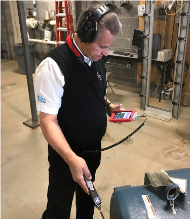

Figure 1: Using an ultrasound instrument to trend decibel readings for trending data (Photo courtesy of The Ultrasound Institute)

Figure 3: Using a grease gun with handheld acoustic lubrication instrument with decibel displayed and sensor (Photo courtesy of SDT Solutions)
When trending bearings with ultrasound, once the reading is eight to 10 decibels above the previous baseline, then CBM, or you could say conditioned-based lubrication, is in order. In this case, acoustic lubrication would be the CBM.
To use an ultrasound instrument to view the decibel at the time of lubrication, you must be able to identify a beginning point. One option is the half-stroke method. As you lubricate using the half-stroke method, when the inflection point is noted, stop and give it 10 to 15 seconds to return to the decibel reading prior to the inflection point.
