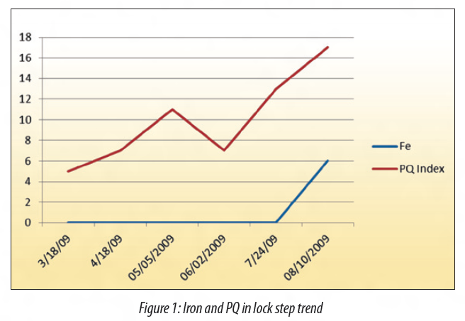

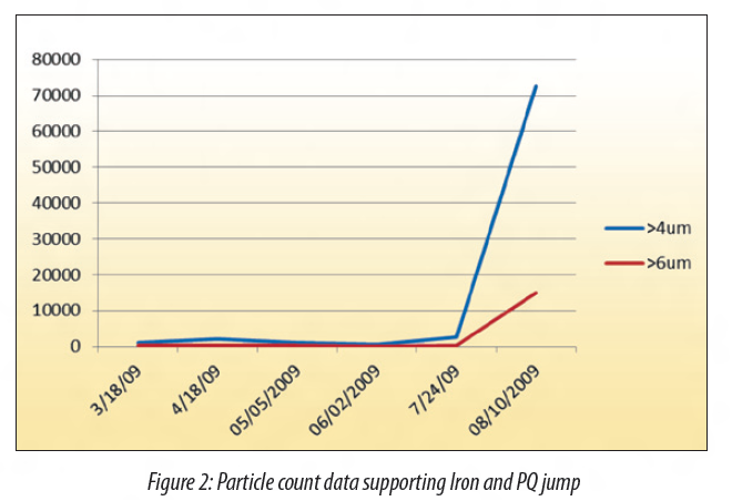

Let's look at a case involving a process critical gearbox at an industrial location that utilized OEM recommended absolute alarm values. This particular gearbox had historically been running 0ppm of iron during the regular oil samples. During one particular sample, the iron value came back at 6ppm. While in many instances, 6ppm in an industrial gearbox is considered to be just noise, but in this particular instance, there was a major cause for alarm. The analyst in this case reviewed the iron data, was able to cross-correlate that data with other oil sample data such as PQ index (Figure 1) and particle count data (Figure 2), all which showed significant increases, called for additional testing and warned of an impending failure.
Unfortunately, the customer in this instance relied on OEM data. The OEM indicated that this level of iron should not be considered a problem by any means. In fact, the OEM quoted an AGMA standard as supporting documentation for not alarming the iron until it reached above 50ppm. The AGMA guideline used was not for the type of gearbox discussed in this example, rather it was for a gearbox used in a completely different application. Five days after the initial warning and request for additional testing, the gearbox suffered a catastrophic failure resulting in the actual casing of the gearbox splitting in two.
