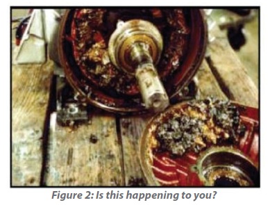

Have you ever heard of "killer PMs"? These are PMs which are intrusive and are known to quite commonly cause premature failure of an asset. One such example might be taking a pump out of service to inspect coupling shaft alignment. Consider carefully that this inspection could be easily performed using infrared thermography or vibration analysis without shutting down the pump. Have you ever seen someone lubricate an electric motor with sealed bearings? These PMs sound unnecessary. Yet these things happen every day.

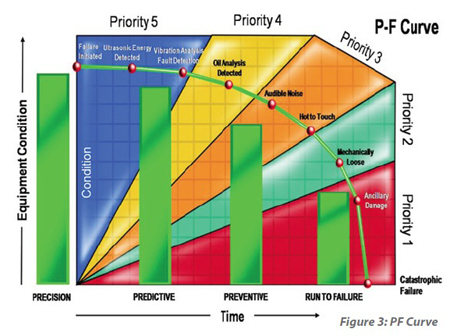

The example below displays the P-F Curve where "P" is the point at which an abnormality begins (defect). The key is that we want to identify a defect (potential failure) as early as possible so we have the time to plan, schedule, replace or repair the item before it fails. Point "F" is the point of functional failure. This is where the item can no longer deliver its intended designed function. At this point there is typically a very small amount of time before total failure where catastrophic damage could occur, which is not good unless Run-To-Failure (RTF) is part of our maintenance strategy. If RTF is your maintenance strategy for specific equipment, contact me and let's talk about this issue.
Fig 3Fig 3
In the graphic above, it is important to notice that Predictive Maintenance allows one to detect a defect closer to "P" than Preventive Maintenance. We call this on-condition monitoring.
