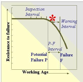

The Elusive P-F Curve
  1. A clear indicator of decreased failure resistance - the potential failure, and
  2. A reasonably consistent warning period prior to functional failure - the P-F interval
Both these requirements are captured in the well known empirical graph of failure resistance versus working age (Figure 1).
Figure 1
The P-F interval is a deceptively simple idea. Deceptive, because it takes for granted that we have previously defined "P" (the potential failure). Of the two concepts, "P" and "P-F", it is the former, however, that poses the greater challenge. Therefore, before addressing the P-F interval, we need to determine when and how to declare a potential failure.
Figure 1 implies that if we could monitor a condition indicator that tracks the resistance to failure, then declaring the potential failure level would be an easy matter. Two stumbling blocks, unfortunately, arise and obstruct our plan. The obstacles to the implementation of Figure 1 are:
  1. A single condition indicator that faithfully tracks the resistance-to-failure curve is rare, and
  2. The resistance-to-failure curve itself is rarely available.
Condition monitoring data, on the other hand, is abundant. How may we overcome obstacles 1 and 2? That is, how may we apply CBM to the numerous physical assets where condition monitoring data abounds, yet, where few alert limits have been defined?
This (setting of the declaration level of the potential failure) is the problem encountered by many asset managers deluged with condition monitoring data. The unavoidable question facing any implementer of a CBM program is where to set the potential failure. Which indicator, from among many monitored variables, should he select for this purpose? At what level? When the physics of the situation are not well known (as is often the case), a "policy" for declaring a potential failure is far from obvious.
