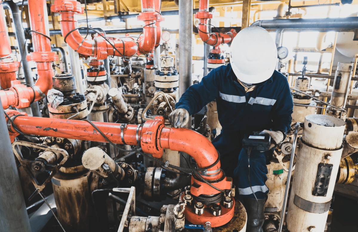

Ultrasound as a Condition Monitoring Tool
During acoustic lubrication, there is an inflection point, which is the point where the decibel goes upward or increases. Not catching the inflection point, could be the difference between over lubrication and under lubrication.
