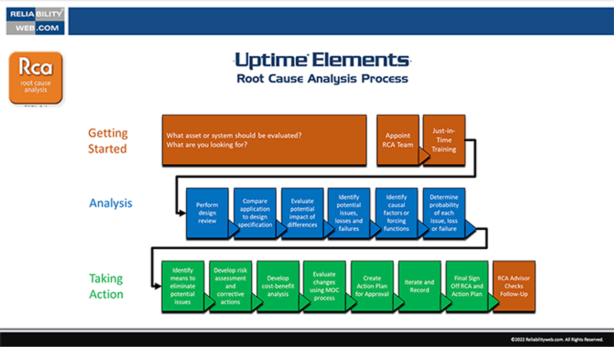

The Root Cause Analysis process
Figure 1 below provides a high-level view of the RCA process. While the primary source or driver for these analyses are to manage risk, losses and sustain reliability. Additional requests can, and often are, made when there is a suspicion that a value stream or work process may be deviating from optimal condition. Regardless of the initiating source, the execution steps are the same.
Uptime Elements Root Cause Analysis Figure 1: Uptime Elements Root Cause AnalysisReliabilityweb.com

Detailed Root Cause Analysis Process
Root cause analysis (RCA) is an integral part of the enterprise’s reliability, risk management and loss elimination process. In the normal sequence of tasks in these three crucial areas, it is performed on those value stream and infrastructure systems that are deem critical by the criticality analysis. The normal progression is to start with the most critical and then in descending order until all assets have been evaluated.
The intent of an RCA is to identify incipient issues that might exist in the processes, procedure, practices, as well as the capital assets, that could present a risk, loss or failure that would affect the enterprise or its value stream. Root cause analysis is not limited to capital or physical assets.
It is just as effective when used to evaluate a business or work process, such as planning or scheduling, as when evaluating a tangible asset.
Detailed Root Cause Analysis Process Fig 2: Detailed Root Cause Analysis ProcessReliabilityweb.com
  1. Select system or asset: Assets are selected based on the relative criticality ranking as determined by the Criticality Analysis (Ca). Business and work processes are selected based on their importance or because they are suspect by someone in the organization.
  2. Collect information: For physical asset evaluation, this information includes functional specifications, vendor or as-delivered specifications, installation drawings, commissioning documentation, operating and maintenance procedures. For business and work processes, it include value stream and process maps and a detailed description of the expected deliverables from the process.
  3. Design review: This should be the first step in both RCA and RCFA and provides a baseline or benchmark reference that is invaluable for the remaining steps in the evaluation. The design review includes, but is not limited to, mass-balance; single-point failures; materials selection; component selection and sizing; input boundary condition; output boundary conditions; and design operating envelope.
  4. Identify inherent issues: In most cases, the design review will identify inherent issues that may singularly or in combination result is a risk, loss or reliability issue. Each of these should be clearly identified and recorded.
  5. Quantify risks and issues: The list of design issues identified in the preceding step are quantified to better define the severity and probability that they will occur at some point in the future.
  6. Application review: A thorough evaluation of the application is the next step in the process. Based on numerous studies an average of 27% of asset failures are caused by misapplication, e.g. the assets are operated outside their design envelope.
  7. Identify gaps and issues: The application review will mirror the design review and a gap analysis performed to identify and quantify the differences, if any, between the design and application.
  8. Prepare risk assessment: This task pulls together the knowledge gained in the design-application evaluations, evaluates the potential risks and develops a risk assessment that quantifies the accumulative risk and probability of occurrence.
  9. Determine corrective actions: A list of corrective actions that address each of the issues identified in the preceding steps is compiled and ranked by relative risks.
  10. Prepare cost-benefit analysis: A cost-benefit analysis is required before the risk analysis can be submitted to executive management for consideration and approval. The analysis should be developed on a line item basis so that each recommendation can be evaluated independently of the total.
  11. Submit recommendations for approval: The risk assessment, recommended corrective actions and cost-benefit analysis are submitted to the executive leadership team for approval.
  12. Execute MOC process: If approved by the executive leadership team, the proposed changes must go through the Management of Change process for an engineering and financial review as well as to assure all changes are fully documented, BOMs and drawings changed, and any skills and/or training requirements met.
  13. Implement changes: The proposed changes are implemented, preferably in a test or control area, to confirm they will achieve the desired results without creating other issues.
  14. Track changes and results: The RCA is not complete until the desired results have been achieved for any changes made. This step tracks the results as well as monitors for adverse impacts of the changes.
  15. Update MOC documents: If the changes generated the expected results and without side effects, all MOC documents, e.g. drawings, BOMs, work orders, etc. are updated and results annotated. If expectations are not met, the project is routed to to RCA-9.
  16. Institutionalize change: The changes should be once again evaluated to determine their potential in other areas of the organization. If so, the changes follow the established MOC process for implementation.
