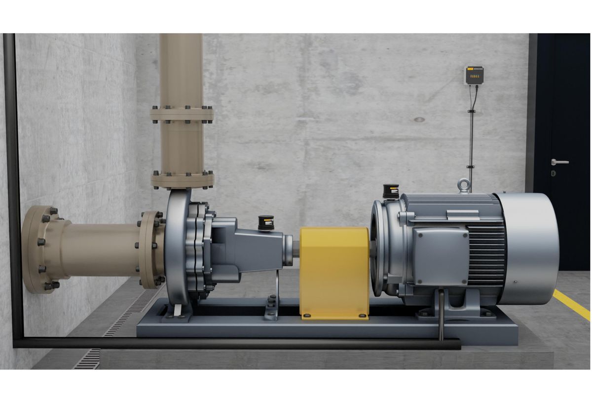

All machinery vibrates, but excess vibration can be an early signifier of potential issues. It can also cause premature wear in components, lead to unsafe conditions and shorten asset life. Vibration monitoring automates the data collection process and makes it possible to detect and diagnose problems before they become severe.
To collect data, vibration monitoring devices are installed directly on machinery. A tiered approach to vibration monitoring involves using analysis sensors that capture extensive data on the most critical assets, while using screening sensors for the remainder. This strategy makes it possible to monitor all assets, without being cost prohibitive.

Screening sensors are an effective way to monitor semi-critical assets, which don’t require full spectral data on a regular basis. These sensors collect quick snapshots of data that can tell maintenance teams whether machines are functioning correctly or not. If a machine isn’t functioning correctly, the team can perform an inspection, collect additional data, and determine next steps. Vibration screening is akin to performing triage.
Critical assets, on the other hand, benefit from more powerful sensors that are capable of capturing more extensive data. Analysis data is much more detailed than screening data and makes it possible to look at patterns in order to identify faults.
