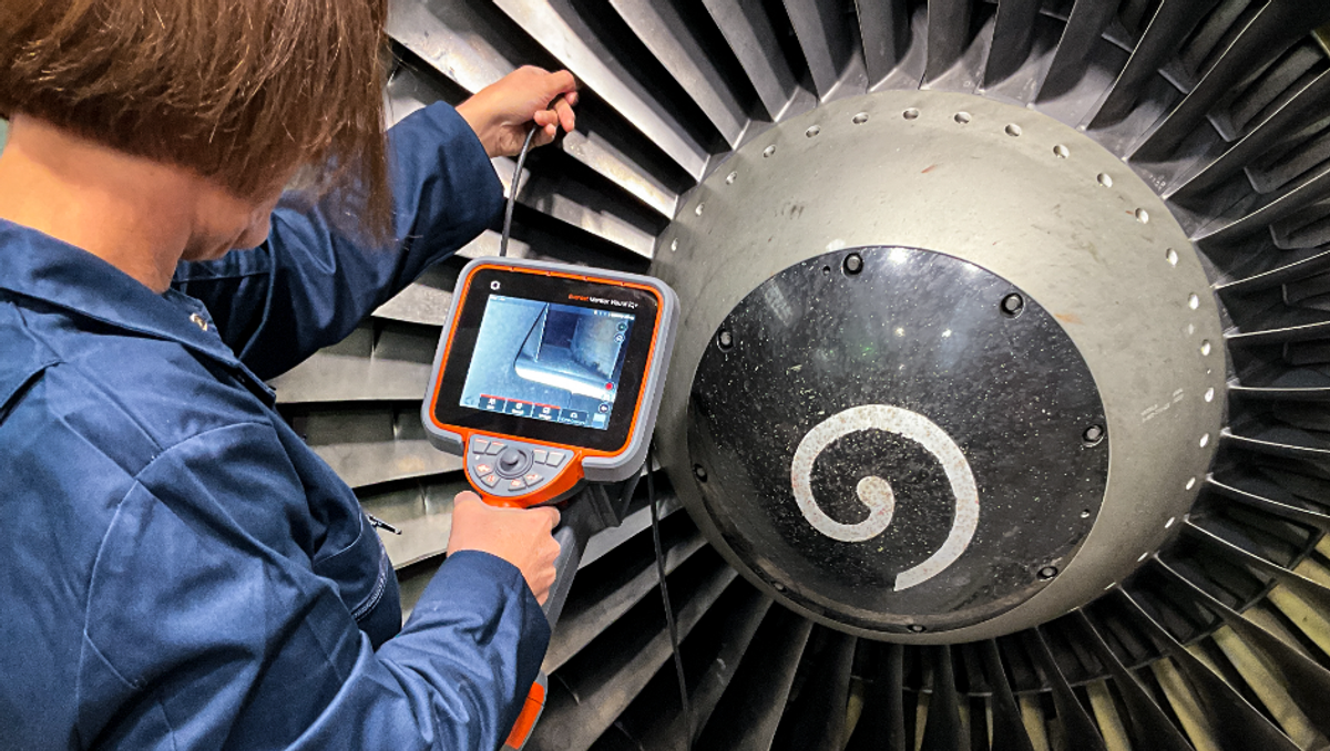

HUERTH, Germany, February 7, 2024 – Waygate Technologies, a Baker Hughes business and market leader in non-destructive testing (NDT) solutions for industrial inspection, has introduced Everest Mentor Visual iQ+, the latest version of the highly successful Everest Mentor Visual iQ VideoProbe™. Utilizing advanced analytics for novel inspection approaches, the new state-of-the-art flagship video borescope technology harnesses the power of Artificial Intelligence (AI) and machine learning to enhance data quality and reduce inspection time for critical inspections across multiple sectors, including aviation and power generation.

With no setup requirements, MViQ+ utilizes machine learning to automatically identify blades and other components within a gas turbine. Moreover, a two-way turning tool integration allows motor control directly from MViQ+, streamlining the entire inspection process. The integrated tool offers on-screen options, facilitating rotation control directly from the borescope handset. This adds substantial value to gas turbine inspections, catering to both aviation and power generation applications.
