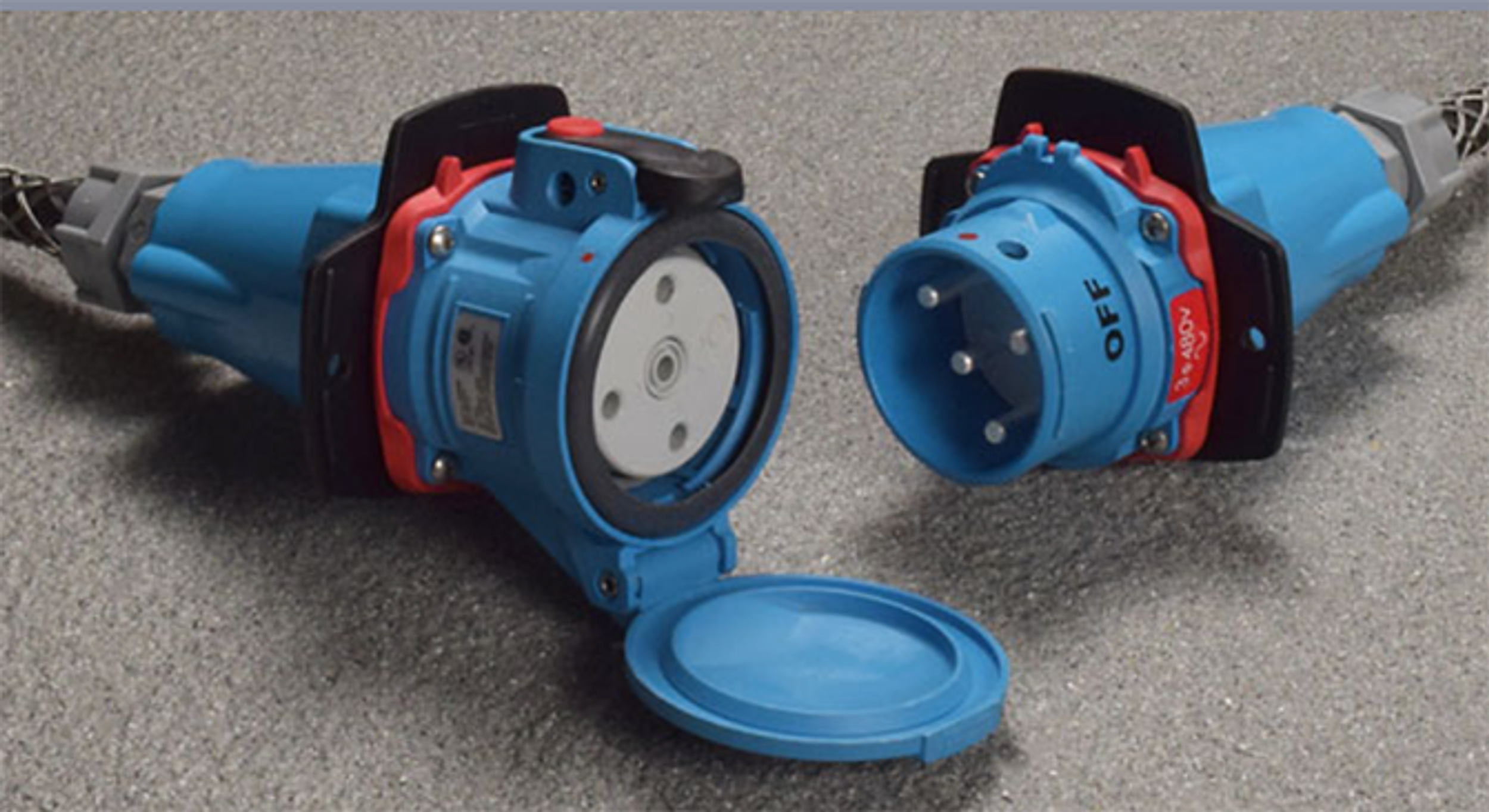

Franklin, WI: MELTRIC today announced DSN100, a new 100 A plug and receptacle.
This new model is a Switch-Rated, 100 A, 600 VAC plug and receptacle fitted with DECONTACTOR technology for peak performance and user safety. MELTRIC’s DECONTACTOR Technology allows their Switch-Rated plugs and receptacles to be safely connected and disconnected under full load, up to 200A and 100 hp, in wet or dry conditions.
They combine the safety and functionality of a disconnect switch with the convenience of a plug and receptacle in one device.
Features and benefits of DSN100 include
.• 100 Amp, 600 VAC
• Horsepower Ratings of:5 hp @ 120 V 1Ø 20 hp @ 240 V 3Ø10 hp @ 240 V 1Ø 50 hp @ 480 V 3Ø20 hp @ 208 V 3Ø 50 hp @ 600 V 3Ø
• Type 4X/IP69/IP69K environmental ratings
