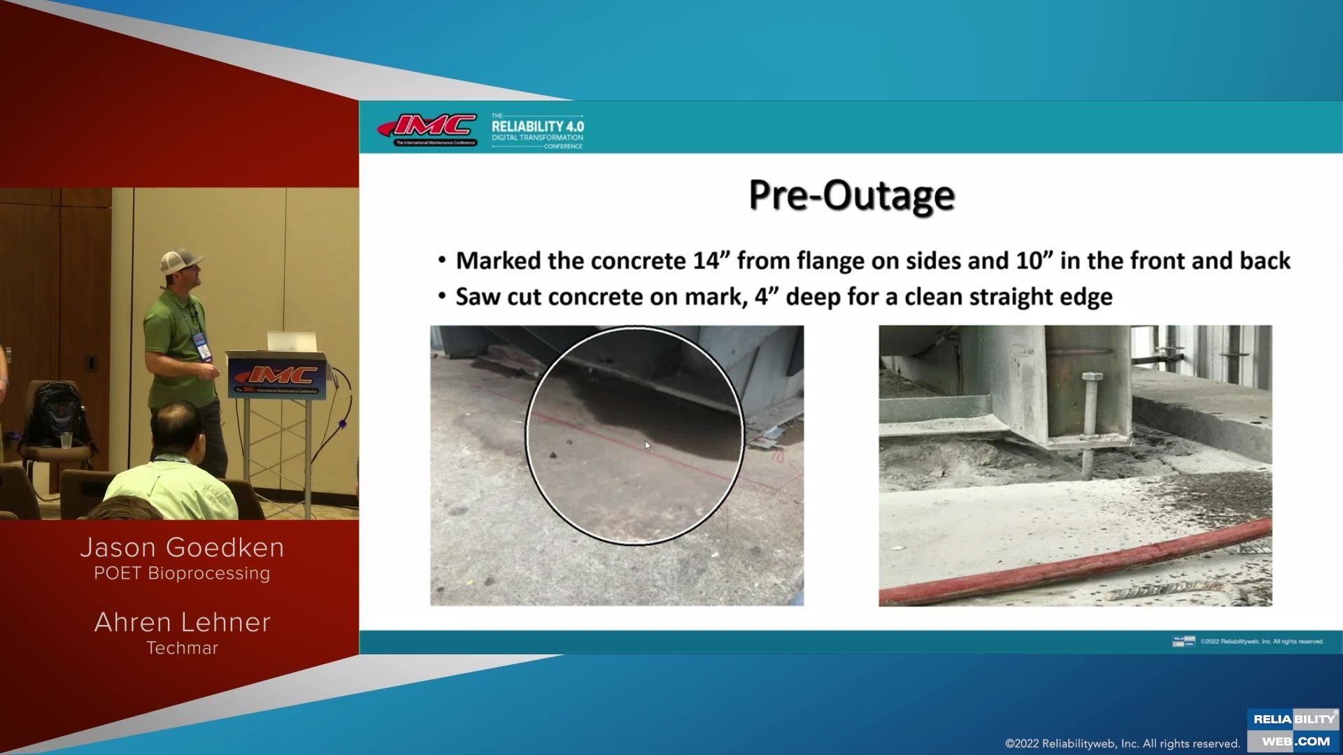

The purpose of this case study is to demonstrate how an organized and effective plan will fix a reliability issue at the source. During this presentation we will discuss the fans history, how our plan was developed, how the plan was executed and the outcome. You will see how vibration was eliminated from the base up. We utilized industry best practices by improving and maintaining proper machine mounting and anchoring.
TAKEAWAY: Examples of before and after proper anchoring was installed showing the results and reductions in vibration readings.
