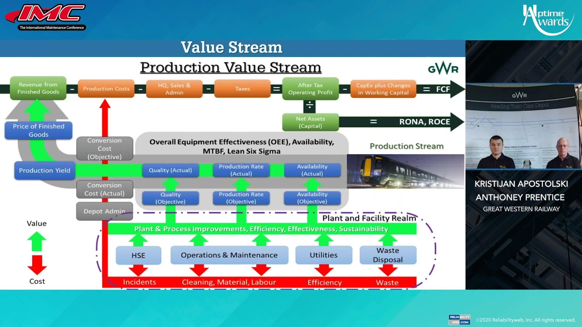

To practice asset management, our assets needed to be identified (creation of an asset register), ranked, assessed, managed and knowledge extracted. We needed a structured approach, and after detailed research within Reliabilityweb.com and IAM libraries wealth of knowledge, we designed our matrix from a combined knowledge of 20+ references.
The matrix itself can be used as a comprehensive self-explanatory, asset lifecycle management and decision-making tool based on risk, to support Engineering teams in practicing asset management.
