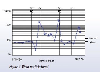

The DR Ferrograph senses wear particles at two locations. First, at the entrance deposit, usually referred to as "DL," and the second, about five millimeters downstream, usually referred to as "DS." The DR Ferrograph senses the presence of particles by measuring the amount of light attenuated at the two deposition locations. The ferromagnetic separation technique causes all ferrous debris larger than 5 micrometers to deposit a few millimeters after entering the magnetic field. Consequently, the "entrance deposit" contains all the larger particles and a representative portion of the smaller particles. No ferromagnetic particles larger than a few micrometers penetrate further than a few millimeters downstream from the entrance deposit. Particle size becomes progressively smaller along the deposition path.
Fig 2Fig 2
Wear Particle Concentration (WPC) is the sum of DL+DS divided by sample size (volume). In most cases, the sample volume is one milliliter, so WPC is simply DL+DS. Percent Large Particles (PLP) is calculated as follows:
Machines starting service go through a wearing-in process, during which the quantity of large particles quickly increases and then settles to an equilibrium concentration during normal running conditions. A key aspect of ferrography is that machines wearing abnormally will produce unusually large amounts of wear particles, indicating excessive wear condition by the DR Ferrograph in WPC readings. If WPC readings are beyond the normal trend, a ferrogram sample slide is made with the fluid for examination by optical microscopy.
