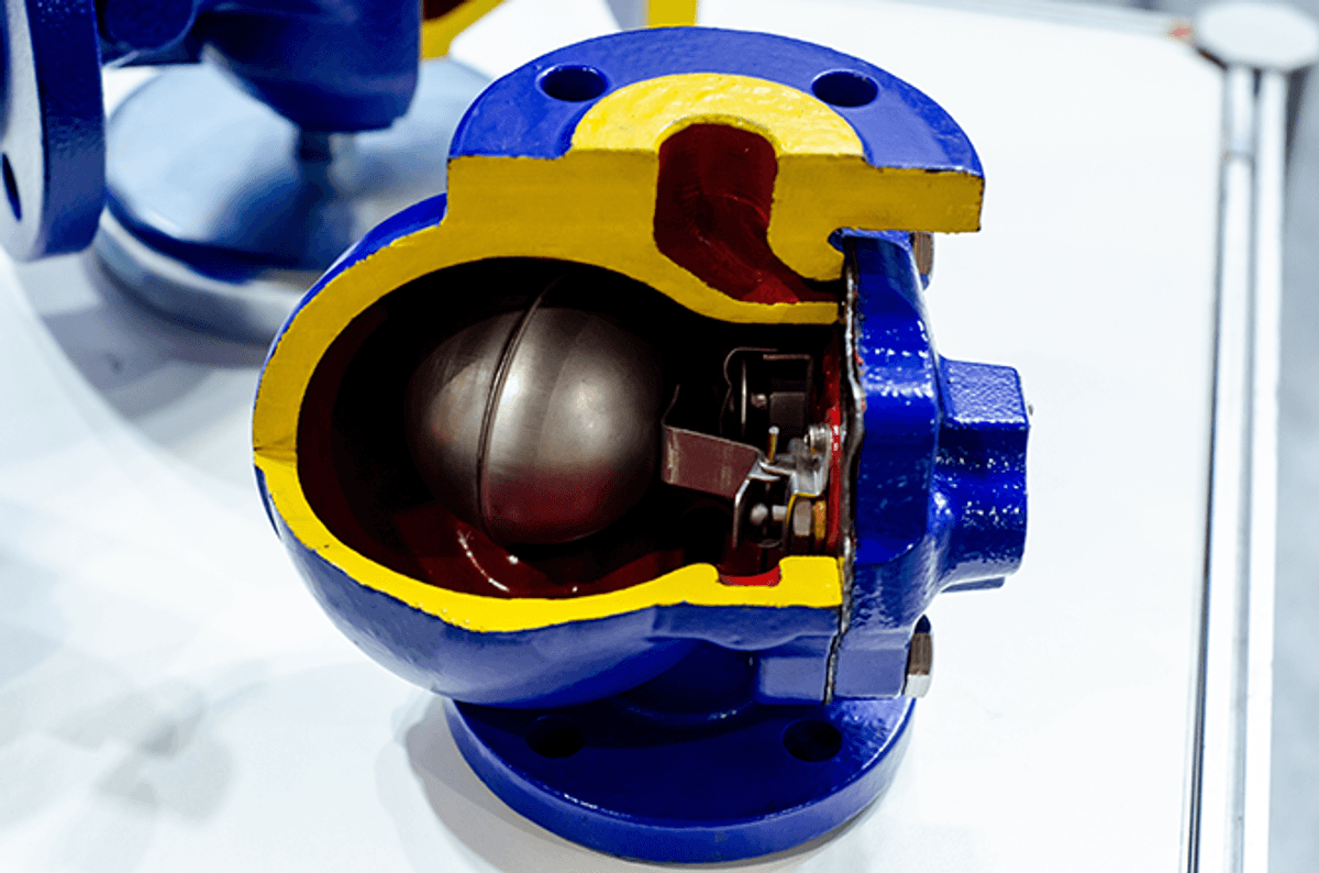

Why do steam traps fail?
Obviously, anything mechanical will malfunction; steam traps are no exception to the rule. Proper maintenance improves longevity and helps reduce maintenance costs.
There are three general conditions, which adversely affect traps:
1. Dirt - by far the leading cause of failure resulting in either a leaking or plugged trap.
2. Pressure surges (due to sudden steam valve openings, improper piping, or trap misapplications) resulting in water-hammer and subsequent damage to the internal steam trap components.
3. Over-sizing IB traps can lose their prime; TD traps can experience rapid cycling.
