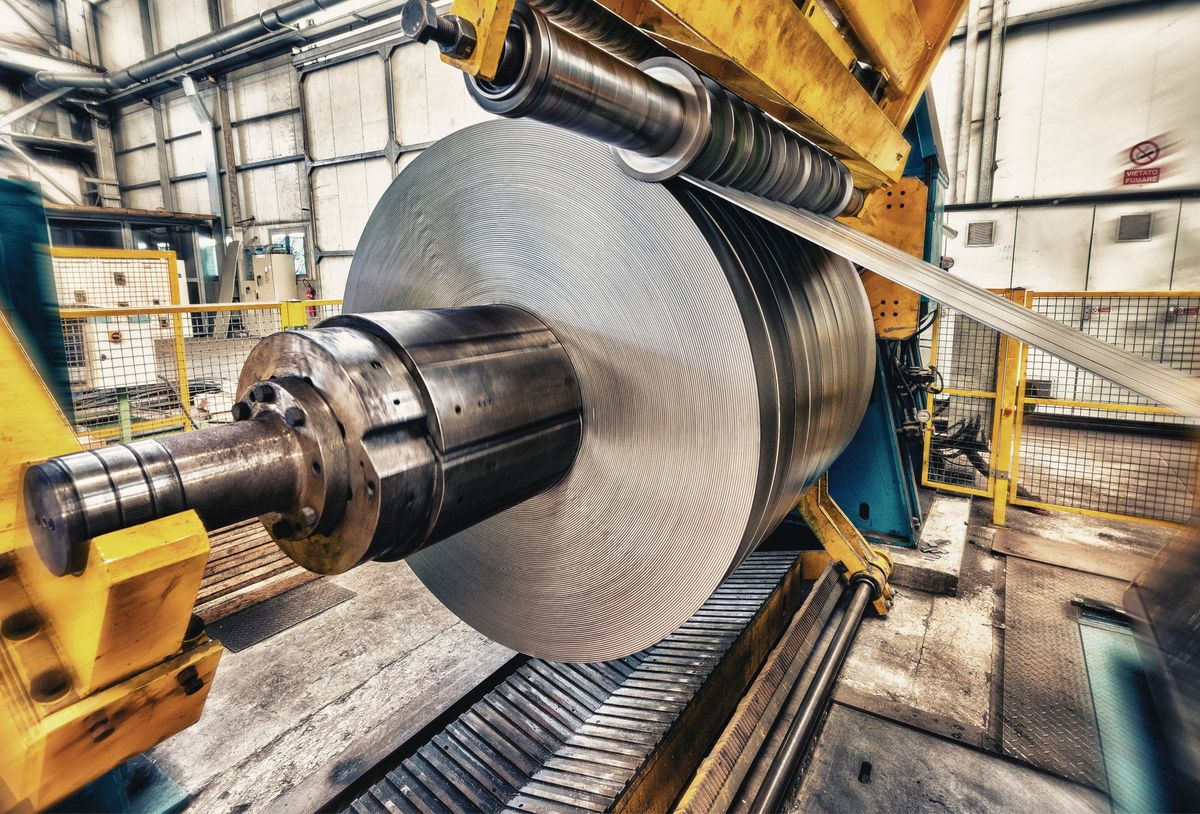

In 2007, the number three worldwide steel maker decided to build a steel mill in the southern United States. Calvert, Alabama , a small town just north of Mobile, was selected. Located on over 1,500 acres, the facility contains a wide range of state-of-the-art steel finishing technologies for processing raw steel into refined products used in industrial and commercial applications. The facility was designed to supply the automotive, pipe, appliance, construction and energy sectors. After construction, commissioning and only four short years of production, this 2.8 million square foot facility was offered for sale. Containing hot strip and cold rolling mills, plus four separate lines for galvanizing and annealing, the facility had a lot to offer. Enter ArcelorMittal and Nippon Steel, the number one and two worldwide steel producers.
