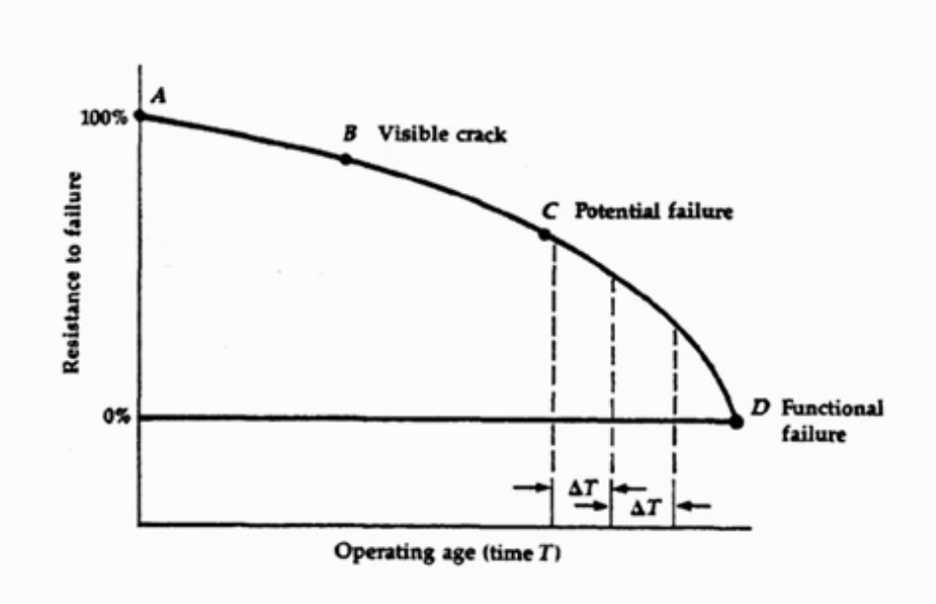

Figure 1: Original P to F curve (Reliability-Centered Maintenance report by Nowlan and Heap)
“Determining the interval for on-condition inspection of an item subject to metal fatigue. Once the rate of decline in failure resistance has been determined, an inspection interval “ΔT” is established that provides ample opportunity to detect a potential [P] failure before a functional [F] failure can occur.” Excerpt from: F.S. Nowlan, “Reliability-Centered Maintenance,” 1979.
